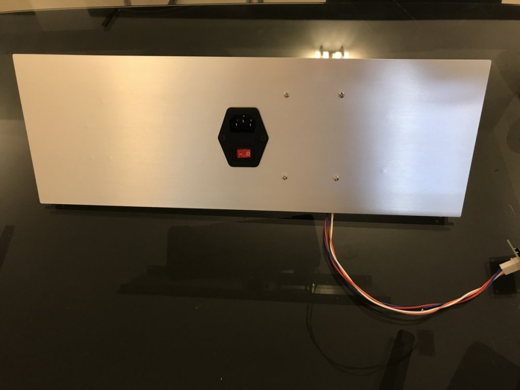

Opening up the rectangle for the IEC was a challenge.  I first used a stepped drill bit and decided that I don't really care for them.  They are fine for smaller holes but bigger holes like the ones needed for the Nuetrik cutouts (24mm) are not going to go well.  I ended up buying a cheap rectangular file and though it took some time, got the IEC installed.

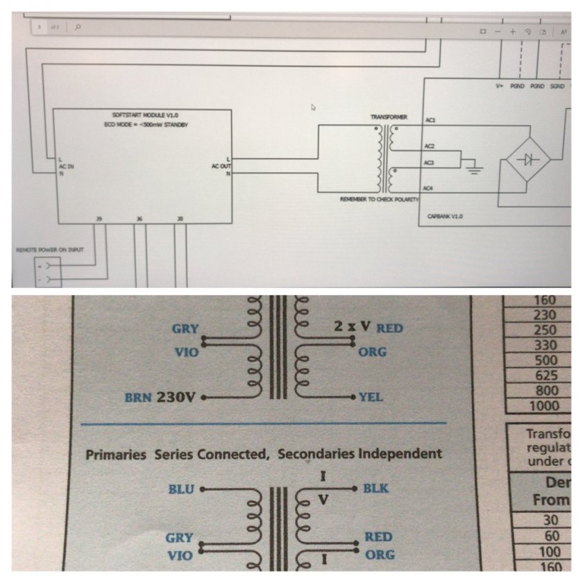

I've wired the transformer to the soft-start
The outside of the IEC
Next step is to wire the transformer to the power supply
