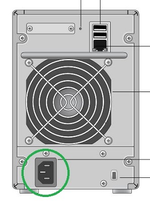

The ReadyNAS NV+ v1 has an internal power supply with a standard AC power cord that connects directly to a back panel IEC AC receptacle.

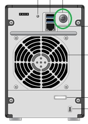

The Ready NAS NV+ v2 has an external power supply brick that connects to a back panel 4-pin DC power jack.
Paul is referring to the v2 with an external power brick (although the connector is a 4-pin plug, not a coaxial barrel connector).
ReadyNAS NV+ v1
ReadyNAS NV+ v2
Which version do you have?

I have the v1 internal power supply.
