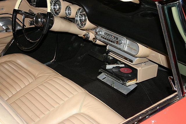

OK,  none of you guys have a clue as to what you are talking about....let's get real here:  CD transfers are for car enjoyment...otherwise, why transfer at all...and why the fk do you want to change a perfect medium in the first place ????
Here's the only thing you need:

klaus@odyssey
Re: lp to cd question
« Reply #10 on: 26 Jan 2015, 09:13 pm »
Ahem...sarcasm !!!  Underlined by a picture ....
This car TT was to be used with the car stoped only.
So it make sense.

Klaus, when you make the Odyssey version of this TT, will it be available in anodized colors or just Khartago black?  The interior color of my next car purchase depends on this.   :D
