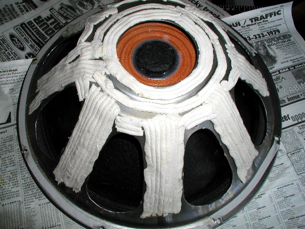

While I had my passive radiator out of my Larger sub to treat with Elmers Wood Glue, I remembered an old tweak for stamped steel speaker frames. Years ago this was semi-common knowledge, but I don't see much mention of it any more.
The "tweak" is very simple and doesn't cost very much. It is fairly easy for anyone to do once they pull the passive or woofer from the cabinet.
All you need is a good sized roll of Mortite. You can also find a generic version in most hardware stores near the weather stripping area called rope caulk.
What the tweak consists of is covering most of the stamped steel frame of the woofer basket with the rope caulk. This will cut down on the ringing of the steel basket. The end result is better detail and definition, less smear, and a much tighter sound. This tweak can be used on ANY stamped steel frame speaker, not just VMPS.
Here is a picture of my Passive radiator and a semi sloppy job of adding the rope caulk:
Anyone coming to RMAF will be able to hear the results on my Larger Sub.
If you decide to try this on your own speakers, please share your results with us.

We do this with Dynamat Premium damping sheets, rather than rope putty, on the RM40 woofers and passives and the RMX woofers and passives.  It's tedious but worth the effort.

Dynamat most likely works better than rope caulk, but it isn't as cheap :wink:

Plast-i-Clay is cheaper than Mortite (like 1/3 the cost).....and is less sticky (your hands are less raw from kneading it around).  It also comes in colors (I don't think Gold tho, Josh  :wink: )
Works wonders.  Frank van Alstine wrote of it 20 years ago.

Even less expensive: the modeling clay from Dollar Tree store or Michael's :
400 gr for 1$, brand: roseart if I remember correctly.
I used  it to line the inside of my mid enclosure.

Michael's has also an "artist" black clay but unfortunately it is much more expensive (< $4 a pound)
Modeling clay sticks well to the crossover parts (caps and coils). Be sure not to put clay on the soldering joints in case you would need to ugrade your XO.

Another good use for the mortite and similar materials is to run a bead around the steel housing used on magnetically shielded drivers. Most of them ring like a bell if you tap them. Since they basically are a bell this makes sense. A bead of rope caulk or mortite does wonders to eliminate the ringing and costs only pennies given the amount needed.
