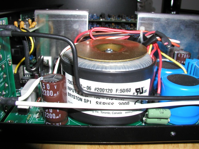

This is what I found in my SP1.7
Toroids by Plitron
KJ
Bryston amps - transformer specs
« Reply #5 on: 7 Oct 2004, 03:10 am »
Sweet close up Levi!   :D   I guess that answers the Plitron question.
