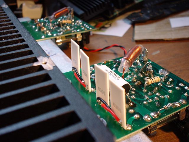

I electrified by accident my first AKSA 55+.
I had reallocated the heatsingk and board from the "old"metal enclosure to the wooden one. To be sure I turned the trimpot for the bias completely counter clockwise and removed the 2 fuses as I has also replaced the 2 ceramic 5 W resistors for 4 damped carbon ones.
See: http://www.audiocircle.com/image.php?id=2736
and
Immediately the R100 underneath the empty fuse holder started to smoke.
It lasted probably 0.75 second before I disconnected the power
My heart stood sunk in my shoes. I saw in a flash that I would send the heatsink and connected pcbs all the way from Holland to master surgeon Hugh.
It took me while to undestand what I did wrong.
I accidently brought the V+ rail female spade from the pwr supply on the output  spade connector of the AKSA instead of the V+ spade connector, which was underneath the pcb, but I forgot.. :oops:  :oops:
Now it is default again as in my other newer AKSA.
What a dumb error. :oops:
 I put the connector on the right spade and started again. No smoke I measured the emtpy fuses
1.2 volts on the one that did not smoke and 3.5 one the one that previously smoked  ..  :(
I already saw the R100 colours were more gray as the resistor was a little burned.
I soldered it out. It measured over 300 ohms.
I replaced it with a new R100 and now both channels were equally 1.2 V  :D
Happilly it happened with the transformator of the AKSA 30+ (25 volts instead of 36, for the tweeter only)
All the other basic measurements were then fine.
Another example how strong the tolerance of the design is for  abberations and grave assemblage mistakes

« Reply #1 on: 11 Oct 2004, 09:26 pm »
Hi Kyrill,
Thank you for explaining your frightening incident......  I am delighted that it has all worked out and compliment you on your detective work after the incident.
I have seen quite a few cases where the positive power lead was connected to the speaker output.  If the fuses are in place, the amp may not survive;  with the fuses in place, it almost always does survive.  There is no doubt that these fuse resistors are a VERY effective way, in the absence of a variac to slowly ramp up supply, of preventing disaster.
Hugh
