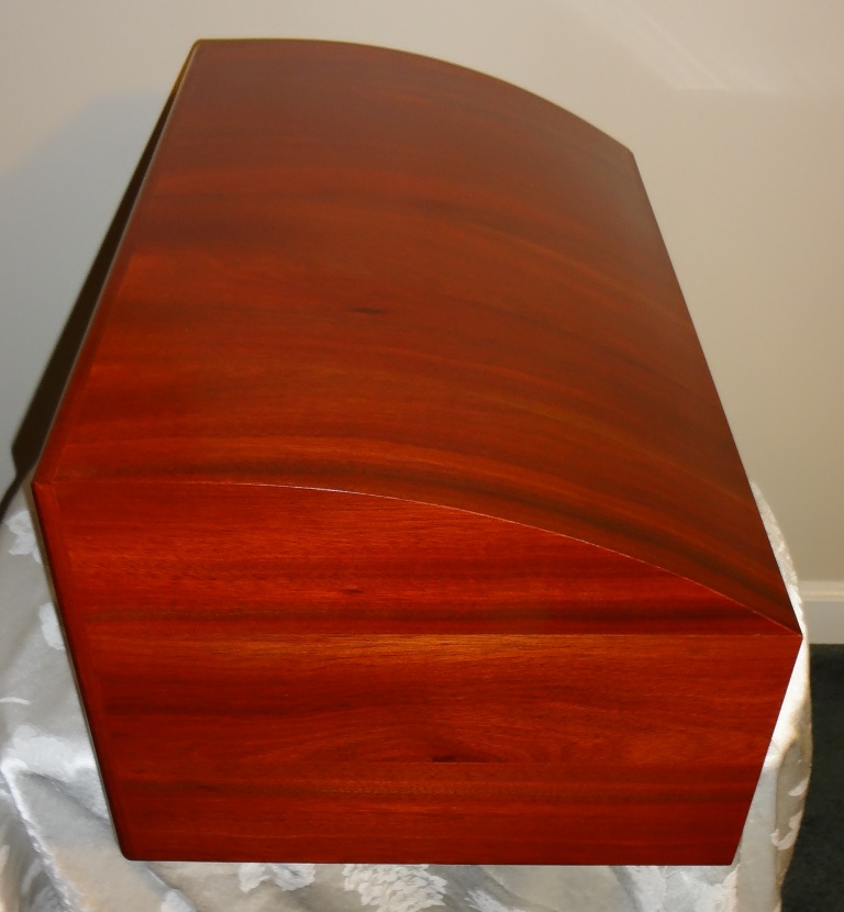

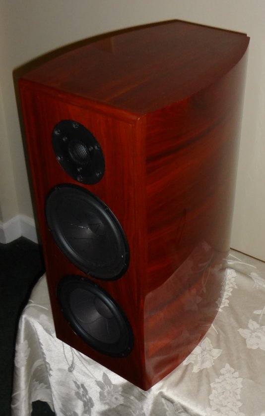

Kudos to my fine cabinetmaker and finisher...

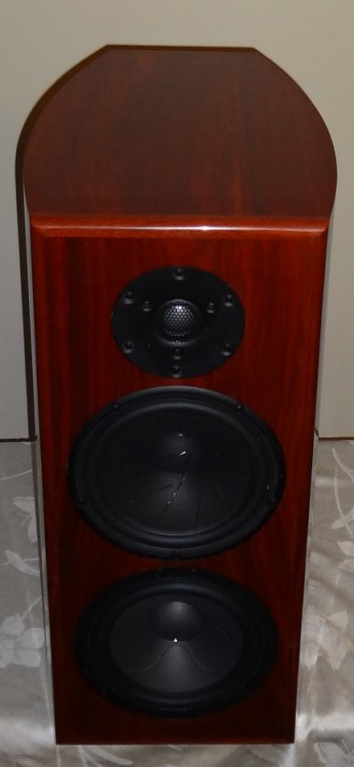

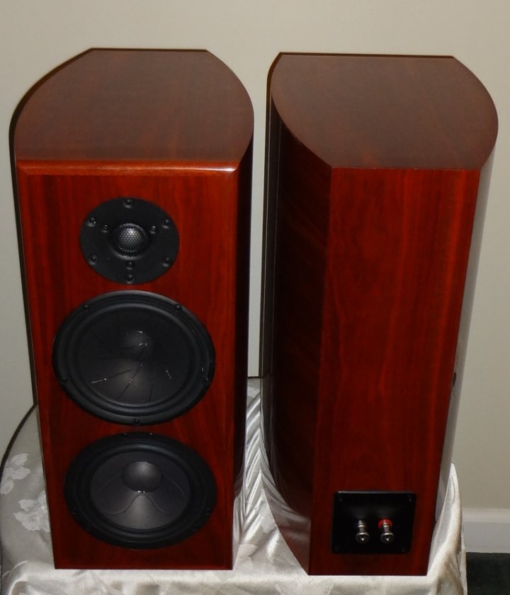

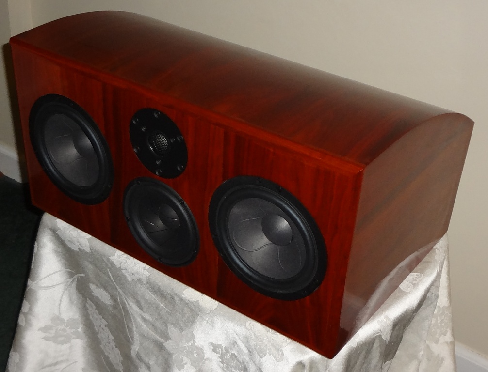

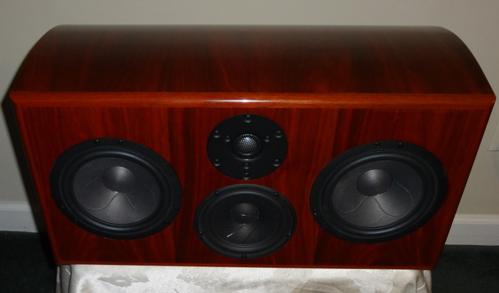

I received a request to re-purpose some drivers the owner had taken from other designs. He also wanted a high gloss finish and curved cabinets so we built new designs from the ground up. The mains are actually a 3-way with the upper 7" Scan-Speak Revelator driver serving as a mid. The lower driver is an Illuminator 7". The center channel shares the same woofers but uses a 5.5" Revelator to keep the height reasonable. All three speakers share the same Scan-Speak beryllium tweeter.

The center cabinet is really nice.
The combination of front drivers are a little odd though.

I agree the center channel workmanship is excellent.  Re the driver config... thinking not that odd...Axiom has done the same with their VP160 and it's been given high marks.

I meant the front speakers. just thought the illuminators arent using to the full potential.

The Wisconsin owner really liked the midrange capability of the 7" Revelator so that's why it was incorporated into the L/R pair. The Illuminator's strongest suit is its' bass and the two drivers integrate very well.
