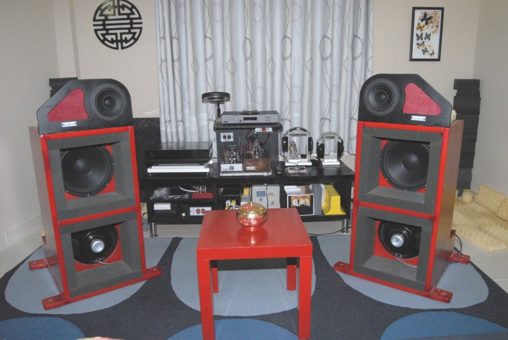

Hi all.
Today it’s Sunday and for me Sunday is my only day off of the whole week, so, what do I do on Sunday?
Audio stuff of course.
I have a small Sony CD/FM/amplifier that I bought 13 years ago and still work fine.
I think that’s before Sony decided to offer his customers some cheap stuff.
I paid at Sony House (Montreal, Canada) 650.00 $ for the main unit with two bookshelves speakers and a small sub-woofer.
I decided to try that solid state 15wpc unit on my Omega 7F and OBD (Open Baffle Dipole) double 12” subwoofers driven with GR Research SA-1 250watts ss plate amplifier.
I found the Sony to have a wider sound stage, but less deep.
The bass, even if the ss plate amplifier is taking care of the bass to be muddy and the mids and highs, without being bad, they were not the quality of the Decware SE84C+ 2wpc SET.
The over all sound quality of the Decware is more natural, clearer with more details, even the bass is better, less muddy, and tighter.
Not that the Sony is not good, but given the choice, I choose the Decware.
I recommend the Decware to drive the Omega speakers and I recommend adding a subwoofer if you like bass like me. You can live without a subwoofer, but once you have one, you don’t want to let it go.
The Decware set at 1.5wpc (3pm) and the Sony set at 7wpc, (17/30) both sounds at the same level, if the Sony digital volume scale is linear.
Again, I will repeat myself by saying that I am very happy with my Decware/Omega combo.

Hi,
What is the x-over frequency you set between the Omega and the Woofer? Your woofer looks like the woofer I use, i.e. Eminence woofer from GR Research.
Also did you use a measuring device to set the x-over freq., I don't think the Omega will go down to very low I suspect  not even  flat at 300 Hz. If you use a measuring device to set the x-over freq. you will be surprise the sonic balance will be different.
Looks like you are enjoying your set-up good luck.

Hi ttan98
The woofers were purchased from GR Research,
but they are 12" Eminence Acoustinator connected in parallel
driven by GR Research SA-1 ss plate amplifier at 250 watts.
A long time ago I did some measurements,
but now, forgot what they were.
The Omega are full range directly from my Decware 2wpc SET amplifier
and the SA-1 plate amplifier's cross-over
is set at 80 Hz and the volume is set at 50%.
I tried many different setting and this is the one that I like the most
because they sounds exactly to my liking, very natural, lots of micro details,
not fatiguing at all.

Guy,
Please take this as a suggestion not a criticism, the Omega driver is too small to go down to very low frequency response esp. in an small to medium size baffle in an open baffle configuration. The lowest freq. my guess would be flat till 500-700 Hz then it starts to drop off. If you cross around 80Hz you would miss the freq. response hence music around 500-100Hz, i.e. the lower to mid bass.

Guy,
Well, not necessarily. I agree there will likely be a dip in frequency response, but a lot of that will depend on his room as well. If the RS5 is getting a little bit of reinforcement from the back wall, I can see how Guy might actually be getting a decent blend at the listening seat. Also, I haven't heard the Decware, but if it is full sounding in the mids and lower mids, this may also help with getting a good blend. There are a lot of things at play, not just the speakers and drivers.

Hi ttan98.
I will take whatever you will throw at me,
suggestion, recommendations, criticism constructive or other.
No problem.
I might be wrong, won't be the first time and surely not the last time,
but I would think that the Omega 7F would be able to go down to at least 100Hz. Maybe you should ask Canada Rob about that.
By the way, my Omega is a 7" not a 5"
Please come back here with more info on the crossover point
for the Omega 7F, I am highly interested in your findings.
Thanks.
