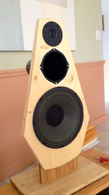

Previously I had the opportunity to play with a few hemp cone drivers in open back.  The material has been used primarily in guitar and bass speakers in an effort to produce a certain tonal signature (voicing).  These speakers are typically highly efficient but their response curves can be a bit ragged for home hi-fi.
There are however a few hemp based drivers that seem to be the exception to the rule. One such driver, the ‘Lil Buddy, is manufactured by Eminence Speakers in Kentucky and is part of their 10” Patriot line. It has a sensitivity of 99.1dB (1w/1m) and a Qts of .84. The response curve is also remarkably flat. I would like to put in the good word for this driver as a midrange in an OB configuration. Coupled with an appropriate bass driver and tweeter, it can be the cornerstone of a really impressive system.
I have spent the past few weeks listening to this driver handle the midrange duties in the Hestia Forte speaker.  In this particular application it is technically used as a lower midrange unit, but I have also listened to it as a wide range driver coupled only to a tweeter and have been equally impressed.
While it has a powerful physical sound, it is also very smooth. The hemp/paper/pulp cone with paper former rolls-off differently than any other driver I have heard. The break-up, even above 5k, is extremely smooth and almost audibly nonexistent.  This adds a sweet character that really seems to lend itself well to the open back experience.
For a guitar speaker it has a very neutral voicing, if anything a bit on the dark side. This character tends to naturally subdue the highest octaves and make crossover work easy. It functions well with a single inductor HP filter, with no real need for additional impedance equalization. And unlike many drivers, perhaps due to its voicing, it sounds fine with a simple 6dB per octave filter. If coupled with a smooth tweeter and crossed relatively high, it might be possible to design a network with only two components.  I have used the driver in the 150 Hz to 5k Hz bandpass with impressive results.
This is one of those situations where it is helpful to hear the driver on an open baffle to properly evaluate.  I would be interested to know if anyone has had a similar experience with hemp cone drivers.

Matevana,
 I agree with you completely. I  listened to a 2way with a Tone Tubby 12" and a Lowther that was quite good. The hemp cones do appear toroll off smoothly without a harsh breakup. I think you're really onto something good.

Hi Matevana ~ A very exciting and interesting thread. I deeply appreciate your taking the time to share your experiences with us of the Lil' Buddy hemp cone drivers from Eminence.
I have come to regard 'smooth' as easily one of the most important sonic characteristics a speaker can have. It creates a more 'relaxed' sonic personality that fits the kind of music that Deborah and I mostly listen to.
I am very interested to try a pair in a simple OB. I have come to feel that observations about drivers from our wonderful OB community would be even better served if we can have a sense of ancillary equipment being used with them. Especially the amplifier/preamplifier. With that in mind can you share with us what amplifier/s you are currently using with your Lil' Buddy's?
Also, what tweeter have you used?
Again, I am very excited that there is a reasonably priced hemp wide-range driver that you really like, thanks for sharing!!
Incidentally, did you prefer it in OB or in a box/cabinet?

The chain looks something like this:
Music server -> Micromega Mydac -> Luminous audio passive preamp -> B&K ST-140 Power Amp (upper cabs) -> Adcom GFA-5500 Power Amp (lower cabs)
I have used the Vifa XT19 and D19 tweeters with this design. I also like the Usher 9950 and would someday like to test the AMT style tweeters (air motion).
Sorry, I have only listened to this driver in OB.
