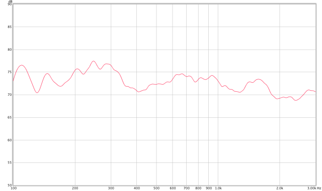

If I've got the dimensions right, this reflection should cause a dip at 400, a boost at 800, a dip at 1200, a boost at 1600, a dip at 2000. Let's see (1/6 octave smoothing):
So you if track the undulations of the graph, you can see that it's actually going up and down about where the floor reflection says it should. Could just be coincidence, but maybe not...
Next I stacked three bolsters midway between speaker and microphone, total 45cm high, 35cm deep, 60cm wide. You can see the floor reflection is absorbed a lot:
The effect on frequency response:
At 800 (well more like 900), 1200, and 1600, it seems to have not only removed the peaks and dips mentioned above but reversed them. No effect at 400 Hz, but for reasons I don't understand, the peak centered around 270 Hz has been reduced. (I thought that was ceiling effects, but maybe not...)
Then I replaced the bolsters with a piece of wood, 45x50cm in size. I had to put it on the floor. Impulse response:
The floor reflection is reduced although not as much as before. The frequency response now:
Similar effects between 800-2000 Hz, no difference below 800 Hz.
In case you're wondering if a rug makes any difference, here is the impulse response with a woollen rug about 12mm thick laid down between the speaker and the mic:
It does give a reduction in the reflection although not as much as either of the above two. Effect on frequency response:
A bit of effect around 900 Hz, a small amount at 1600 Hz, not much elsewhere.
No specific conclusion at this time. I'm thinking maybe something that is a combination of absorption and reflection that can be placed on the floor might be best. I'll think about how to test the ceiling reflection.
