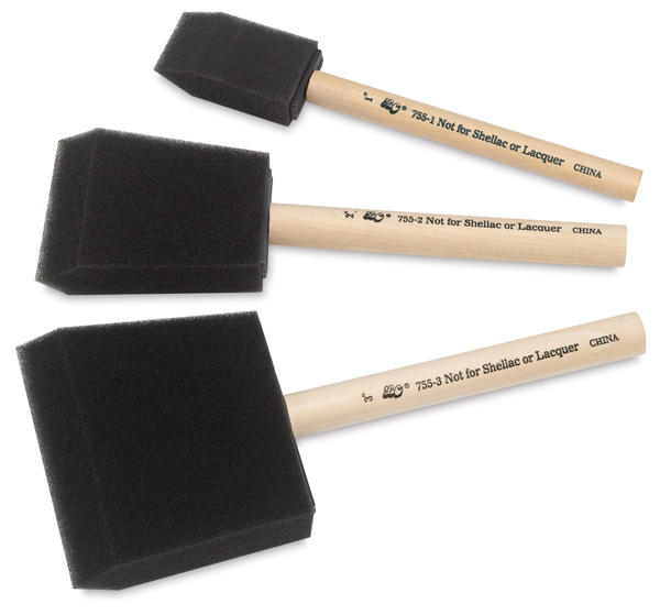

Dr Earl Geddes has spent a lot of time developing various densities and shapes of open cell foam to control directivity with his CD drivers. There's some interesting stuff on his commercial loudspeaker site as well as a short white paper here: http://www.gedlee.com/downloads/Philosophy.pdf
I haven't experimented with it but it occurs to me if you wanted to try out the concept you might start with the foam from a brush like this...

Some manufacturer's have used foam as a speakers grill, which would imply that it is acoustically fairly transparent, so I have my doubts as to whether it could make much of a difference?

Yes shorter ribbons, like those found on Adam's professional monitors, would be more desirable but I have my doubts about the effectiveness of foam or of smucking up a nice/expensive driver that someone has apparently thought long and hard about with hardware supplies.
