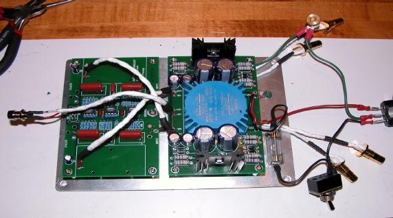

I'm in the (hopefully) final stretch of putting together the Bugle and Power Supply. It's been quite an enjoyable experience :)
One of the final touches I'd like to do is hook up the LED on the power supply as a power-on indicator.
The voltage I get across LED+, LED- however is approx. 30 volt dc. Is this correct? If so, anyone know where to find a 30 volt dc led?  15 volt dc is the greatest I've been able to find.
Thanks in advance,
--eric

« Reply #1 on: 22 Jun 2004, 06:10 am »
The open circuit voltage on the LED outputs is indeed 30V.  But it uses two 1k resistors in series to limit the current.  The LED (use any regular type or color) is a diode with some forward voltage drop (2V for green, 3.5V for blue).  Once connected, it draws current through the 1k resistors for about 14mA current.  That should make it pretty bright.
In short, just connect a regular LED to the terminal on the PCB.

The amp and powersupply are now connected and all of the voltages look good! The little blue LED power indicator even helps make this amp look good naked :)
now... to build a chassis... Er, question to all Bugle builders out there, what are you using for chassis?
Oh, and thanks again Jim! Excellent kit(s)!
--eric

« Reply #4 on: 24 Jun 2004, 05:10 am »
Erimille,
Turn the Bugle board around.  Face the inputs to the outside, away from the power supply.  Quieter that way.
jh :)

I finally got around to reoriented the preamp and the power supply. Further I decided to stack these boards (to save space) on either side of a http://www.radioshack.com/product.asp?catalog%5Fname=CTLG&product%5Fid=276-1499">radio shack copper pc board in an attempt to help cut down on any interference. This pre-amp is now much more quiet! Thanks for the reorienting suggestion as this as indeed paid off. :)
--eric
