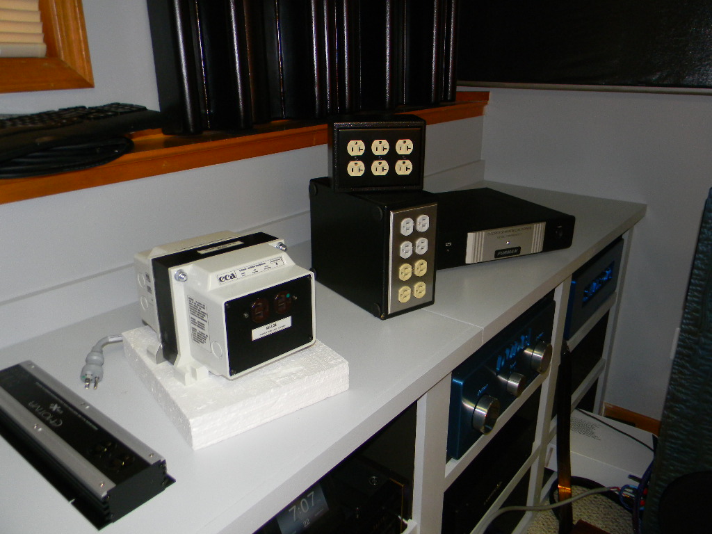

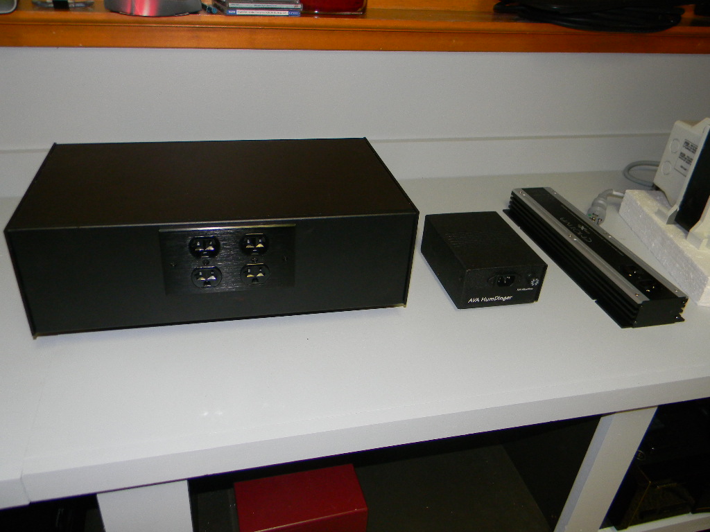

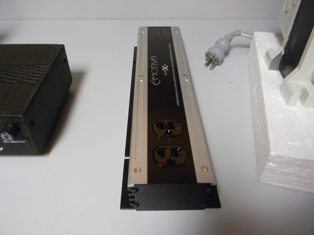

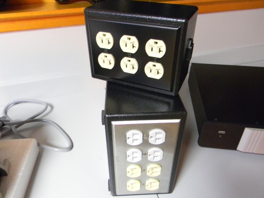

Here is the Emotiva unit.  Single duplex, nice and beefy unit.

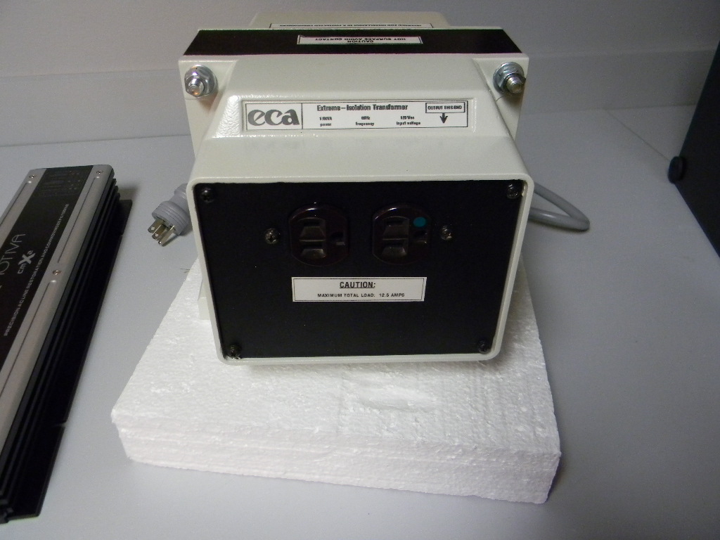

How about an isolation tranny? 1.5kva EAC unit - heavy!
How about taking the bus?  UberBuss and BussStop units from Mr. Dave.

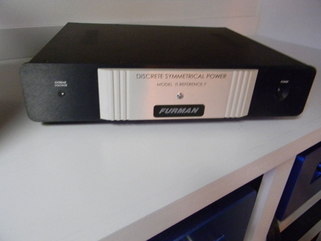

And finally, how about an older Furman unit - Ref 7i or something like that.  Also very heavy!

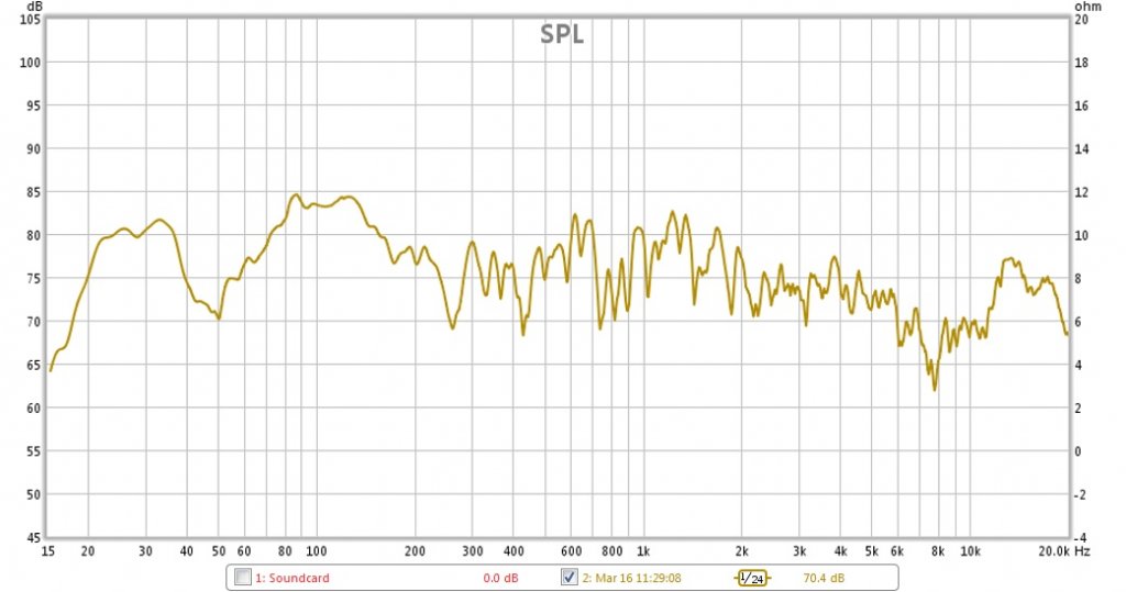

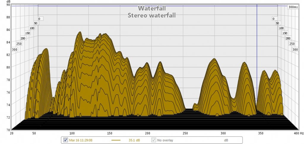

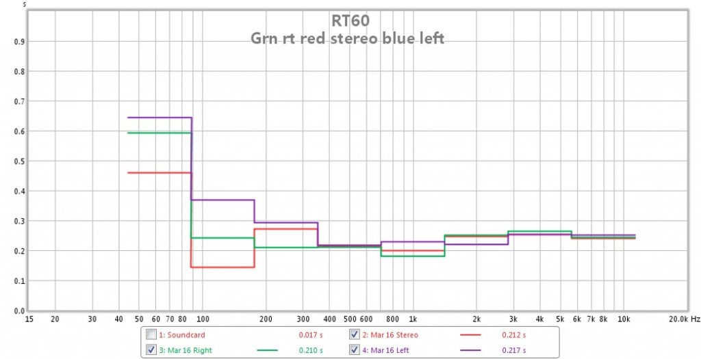

« Reply #30 on: 16 Mar 2014, 05:39 pm »
I cured my noise problems when taking measurements so I have some new plots of the room.  Not bad.  With an opening right to me right ear and the long wall off my left side, the independent left and right sweeps are different and the summation into a stereo plot is often a cancellation of the two as you can imagine.
