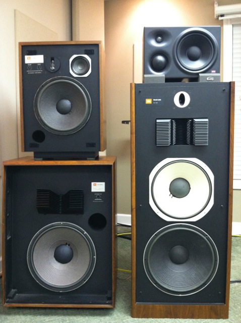

These JBL pairs (in first picture L65 left top, L200B below L65 and L200 Tall Speaker - plus a pair of L100s not shown) are on the block as soon as I can discern a reasonable value.  All cabinets and original grills in A- condition, no evidence of reconing showing and a little contact cleaner needed on hi and lo frequency controls).  Anyone with an audio gear Blue Book willing to help?  PMs and offers also welcome.  Look forward to being a part of this group going forward and all speakers have been in my family - no other owners).

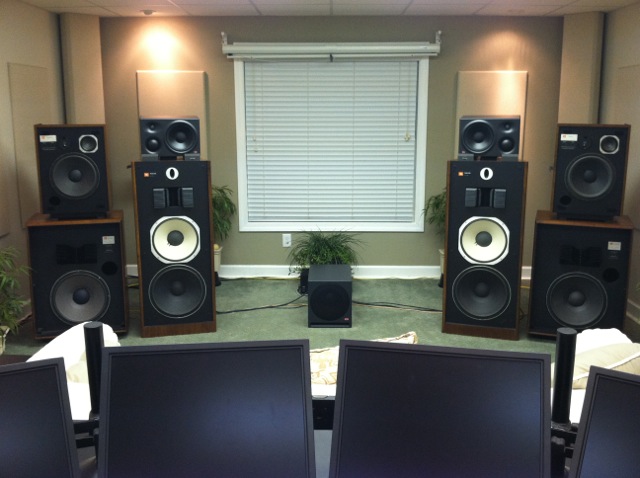

and by the way, the subwoofer looks like a Chihuahua amongst St. Bernards!
