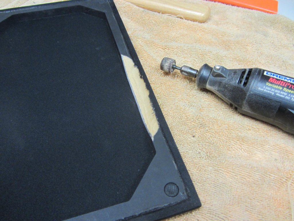

How did you get the grills to fit over the woofers?
I used a dremel tiny drum sander to carve it out.

NeilT -  In order for the grill frame to fit over the woofer flange, I used 3/8" diameter x 3/16" high neodymium disc magnets glued to the existing grill magnets at each inner corner of the grill frame. I secured the disc magnets to the existing magnets using just a drop of Gorilla glue. The added neodymium spacer magnets work perfectly which eliminates having to notch the inside edges of the grill frame.
NeilT
Re: X-LS Encore Build with PE Cabinets
« Reply #4 on: 15 Dec 2013, 08:41 pm »
Great idea and it looks good.
