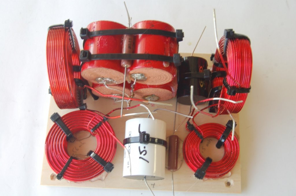

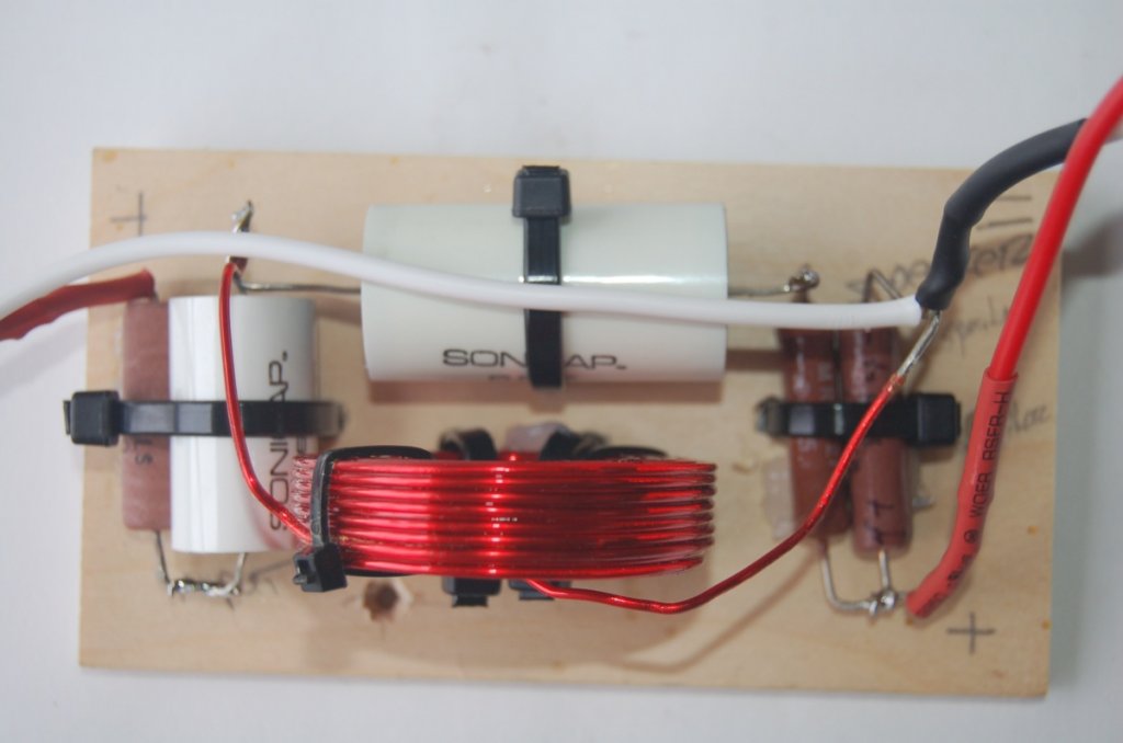

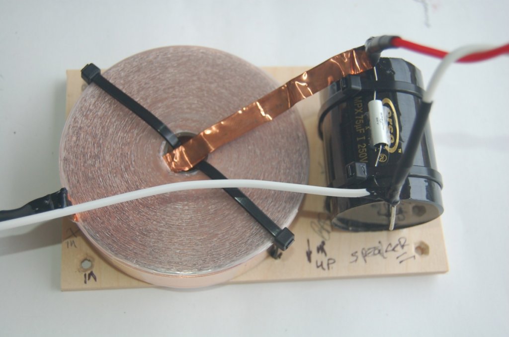

For those that may have missed it..Danny had done some 626 upgrades for others in the past, maybe 7-8 years ago, but I sent him one of my VMPS 626 speakers to measure and evaluate. As you can see from earlier posts and the measurements on here and HTS he made a huge improvement. Now, I added the final touch, bypassing the treble caps with Sonicap  Platinum's and have about 200 hours on them. This turned out to be the crowning touch. Not only did it make the treble distinctly clearer, but the midrange got a little more mellow on voices, although there is no logic to this. These crossover pictures are before the Platinums. Compare this to your stock unit and the difference is very apparent.
There was more to the build mod than just the xover. The cabinet volume was reduced, the port lengthened and more stuffing was put in the box. But now, I have a monitor that, sitting 13" from the rear wall, measures flat to 30Hz. You read that right. But of course there is not a lot of air movement with a 6 1/2 inch driver, so the subs are crossed over at 40Hz with a fourth order slope.
