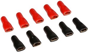

I've got it soldered up! Now for connecting the speakers. I am temporarily going to use those female crimp connectors as that's what I have. I figured it best not to solder the speaker leads so I can remove them for finishing the cabinets and such. Is there a better looking connector that you or anyone else can recommend? I was thinking maybe just the bare female ends that I can solder to the wire? But I'm hoping for something more attractive.
I'd use whatever you have for testing, once  you know it all works then disaaemble for finishing,  solder the connections and  use a bit of shrink tube  over  each if you can when you re-assemble
Parts Express has some gold-plated 1/4" Female Quick Disconnect Terminals, but (a) they do only come in 1/4" size and (b) the vinyl insulation completely covers the gold plating (which you could cut back if you wanted, though).
Using slip on connectors to the speakers will degrade the signal. Don't use anything like that. Just solder the wiring directly to the drivers then seal them with the heat shrink that is provided with the kit. It will look very clean. If you need to un-solder them for any reason then they un-solder just as fast and easy as soldering them on to begin with.
