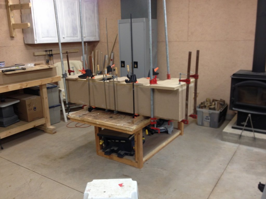

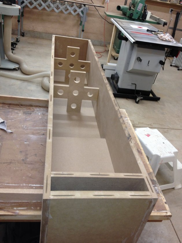

The design came from a conversation of the distributor of the Mach 5 Audio MAW-12 woofers I am using.  I drew up the sketch, and advised of what bracing, volume and port I wanted etc.  He took my design, and created the sawdust, and I picked it up this AM.
It will use a pair of 12 inch woofers, 4 cubic feet net, tuned to 22Hz with a 2 inch slot port.
Pics below.

I would add a couple more braces though for a 6ft sub box tuned to 22hz.If it in wall and can touch anything(studs,etc.) it will rattle.BUT I hope not.Looking good
mcgsxr
Re: New subwoofer build - assisted DIY near Toronto
« Reply #3 on: 3 Mar 2013, 11:42 am »
Is to be completely isolated from studs and walls inside the wall.  Will be tapcon'd to the floor.  Braces to be added if I can reach it.
