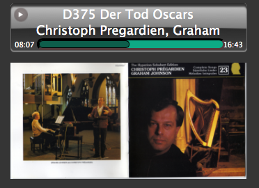

coverart shows wrong jpg
« on: 26 Aug 2012, 08:40 pm »
Hi,
Been trying to give most albums a cover.jpg and a back.jpg (which most of the time have the track listing) Sometimes even more jpg's, with lyrics, photographs etc etc. In Max ( 1 and 2) the first .jpg is shown when available, instead of the desired cover.jpg  :scratch:
Is it possible to correct this? the naming is irrelevant apparently, when more jpg's are available, it just uses the first.

The Sept 21 release should fix it, I accidently made it cover.(any extension).  I changed it to ignore case sensitivity. The priority is now (ignores the cases)
Folder
Front
Cover
First found in alphabetical order
Chris

All too often when downloading coverart, folder.jpg has both front and back sides next to each other in one jpg.
Cover or front, as it should, only the cover (or front...).
Your chosen priority now makes those folder.jpg's show up, while in fact we need the cover or front.jpg. Couldn;t you make it user selectable? Those folder.jpg's are nice but the interface really needs the frontview of cover.jpg or front.jpg.
the other option would be to manually change all names..... please don;t have us do that  :?
Marius
