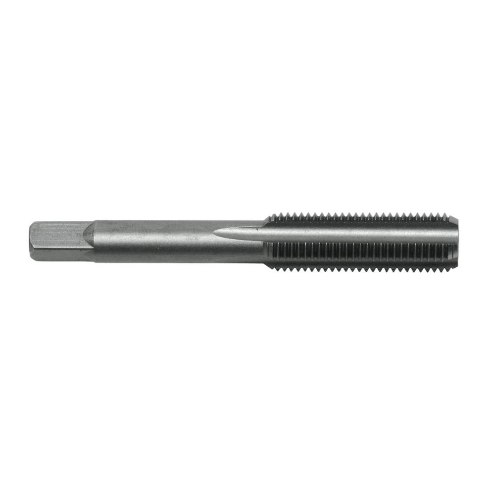

You should be able to repair that clamp.
Do you own a tap and die set or know how to install a HeliCoil?
It's easy.
It's easy.
Sorry to keep modifying this post.
I second this, it would take about 5 minutes.  :thumb:

Go to the hardware store and buy a Tap and run it down and clean up the threads. 1/4" x 20 TPI
$4.99 at Sears
$4.99 at Sears
http://www.elusivedisc.com/search/BDRVPICLAMP.htm
Cheap enough ??
http://www.ebay.com/itm/760-gram-Heavy-duty-Record-turntable-stabilizer-Weight-Clamp-/330795970492?pt=Turntable_Parts_Accessories&hash=item4d04f9efbc
As recommended, I picked up a 1/4" 20TPI tap and it fixed the messed-up threads perfectly.  Thanks for the help everyone!
