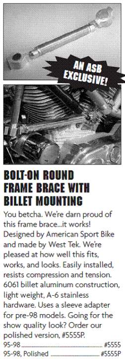

I don't know if ASB makes two sizes or not but the one I have went on the S1 as it was too big for the S2.

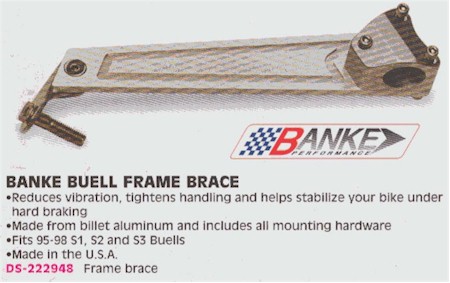

i was unaware that the tube size was any different between s1/s2/x1.  i was also unaware of any different brace dimensions offered by anyone for the s1 or s2; afaik, they were all the same.  i know the x1 doesn't need a brace; there's one already welded in from the factory.
the banke brace on that s1 in the pic is the exact same brace as on my s2, and i know when they were offered f/s, there was one part for both bikes:

Without going out to the garage and measureing I'll bet it's the front tube that's different sized.
The ABS brace has two clamps which explains why the Banke piece worked and the ABS one doesn't.

ya, the banke bolts on at the front bolt that holds the lateral stabilizer; the asb clamps to the frame yust above the bolt.  according to asb, you need a sleeve for '95-'97 models, so the frame must not be as thick...
