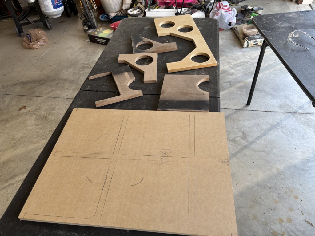

Started cutting braces and sketching out a box with the woofer toward the bottom.

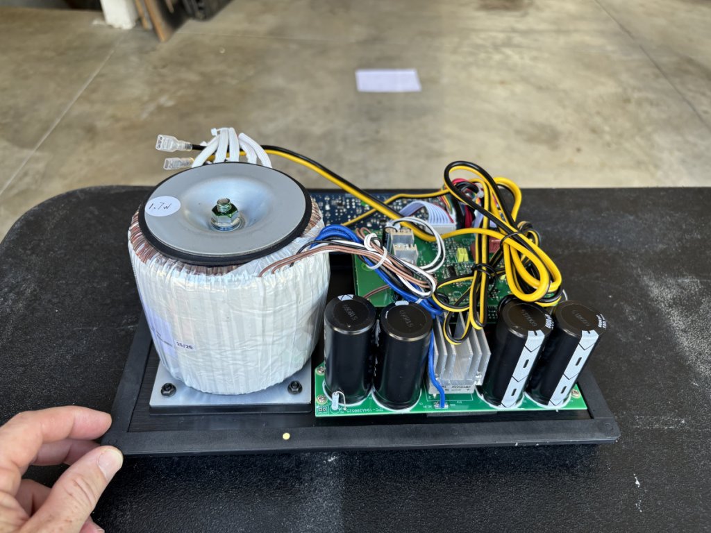

The HX1000 plate amp has a large power supply so it will have to mount on the side and be toward the top of the enclosure so it doesn't hit the driver.

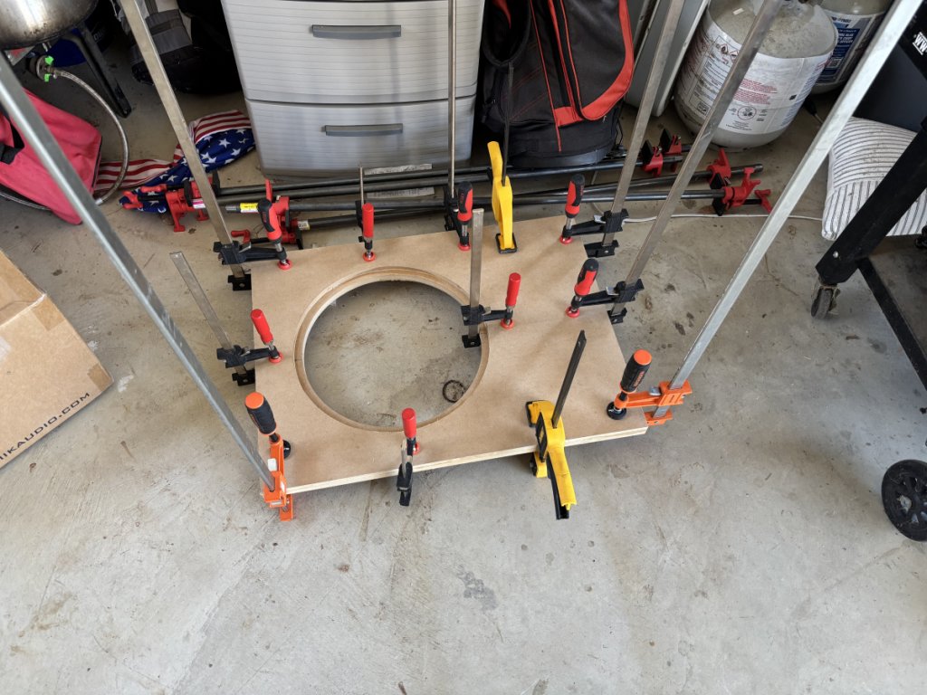

The Driver basket mounting depth is basically 1/2” so I cut a hole in a half in thick sheet of MDF and then glued that to a 3/4” sheet for a baffle so the driver is flush mounted.
