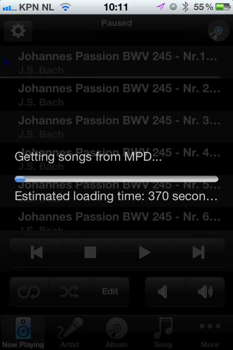

The only complaint I have with mPod/mPad is the 180 seconds it takes to redownload the mpd database to the phone.
Jim
that's quite fast actually, taking longer and longer in my situation:
fortunately it doesn't really take that long most of the time  :D
