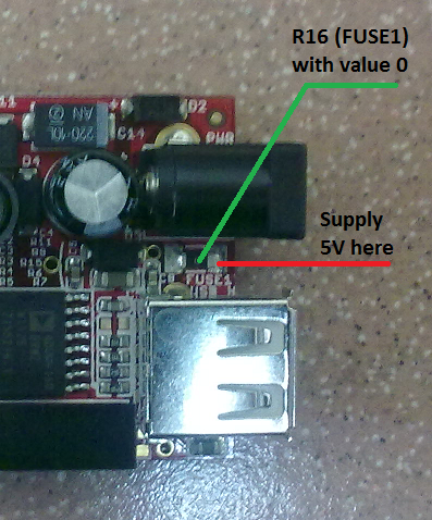

For purists who hate like I do all switching RFI generating dc-dc regulators:
What you have to do is:
1) Remove black rubber sleeve
2) Remove resistor R0 (FUSE1) – it is located between PWR jack and USB_H host (while unsoldering it be careful with C8).
If you remove R0 the power from the USB host will be disconnected so no need to alter your cables. If you don’t remove R0 and you follow the instructions onward you will have two supplies and probably would damage the board.
3) When R0(FUSE1) is removed there would be two pads left. Provide 5V to the pad near the end of the board (Not the one near C8).
Please be sure that you provide exactly 5V (not more) to the pad.
I attach a picture with explanation of the above.
Best regards,
Lub/OLIMEX
