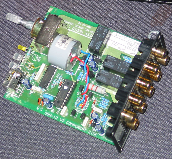

« Reply #4 on: 17 Mar 2004, 06:35 am »
Hi Hantra,
I've been putting some thought into DIY volume controls for projects as well lately.
I opened up my Creek OBH-12 and took http://www.audiocircle.com/image.php?id=2551">a few pics for you.  There's some Omron G5V-2-H1 relays that handle the input switching and two wires that go t the motor on the motorized pot.  The pot is pretty good, but at the price of the Creek, it's probably nothing special compared to the $100 pots you can buy.  I bet you could motorize your favotite pot with some toothless belt pulleys, using light belt tension as the clutch so that you don't have to fight the motor when you turn the knob.  I have no idea how much current is available to the motor, but I'm guessing that there's not enough to power a motor that would turn a 24 position switch like an Elna or what's in the DACT for instance.  For that, you might need a stepper motor and a micro controller to ensure that the switch falls nicely into the detents.
There's certainly a lot of cases when a transformer would help with current and impedence problems but pots or resistors would hinder, for instance when driving longish cables as a passive preamp does.  Ultimately, however, transformers do introduce a whole bunch of wire and a magnetic field to the signal, so they're not perfect.  My impression is that where output impedence and current aren't such an issue inside a component, resistors are superior, and pots may not be far behind.  There's a reason why there are so many output transformerless amp designs.  Ultimately, I guess you'd just have to try them both in your circuit to know which sounds better.

just by looking at that pic wongstein (of the creek), you can see its filled with junk components.
That device would kill the sound no doubt about it.
However replace all those caps with film/ foil types and your in business.
Probably cost a bit to do that though!
actually when im giving my system a serious listen i just hook the player up directly to the amp by-passing my modified passive volume control, nothing in the signal sounds better than even film/foils in the signal.
naturally its bloody loud though :P
