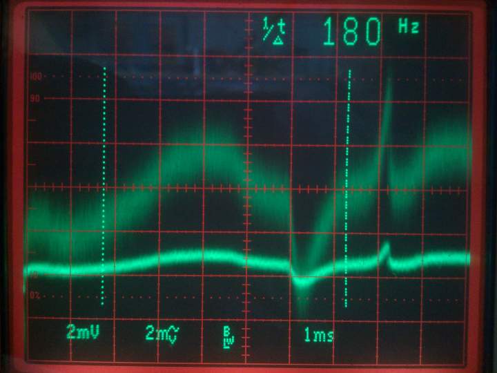

I had a chance to sit down for a few more tests.  This time, I continued to test various points through the output capacitor.  I used a pair of cheap (so as to not be sad if I destroy them) headphones to listen.  I could hear nothing when connected directly to the output--not surprising--, but could when using the amp's speaker level outputs.  Of course, this gives me plenty of signal to hear!
With this connectivity, I am able to hear noise on the grid of V401, with or without the tube installed.  There is a hum that is much louder, but some audible white noise.  The white noise is considerably (10 times?) louder at the cathode of V401.  There isn't as much hum after V401.
I can, maybe, see a factor of about 2x the noise amplitude between these points by oscilloscope, measuring at the OUT RCA.  Here's a comparison:
(All:  Top trace is 400uV/div, bottom trace 2mV/div.  The scope channel 2 is cascaded into 1.)
C409 connected to ground at V401.   This shows the cleanest signal my measurements might be expected to produce.
This is C409 connected to the grid:
Here's to the cathode:
And, to the plate:
I am tempted to assume that the difference in amplitude between the grid and cathode is due to the low impedance after V401, and a higher impedance before.  Is this a reasonable assumption?
The noise is still not present on the high voltage rail, or the ground, with or without the tubes installed.  Hum, of course, is.
Listening after R429, I can hear the noise only when V400 is present.  I also removed V401 to avoid applying a large voltage to its grid.  Substituting R429 doesn't change the noise.
Thanks again.
~Jacob
« Last Edit: 6 Nov 2011, 01:26 am by jacobmj »

jacobmj
Re: Chime rectifier voltages, gain, and reducing noise
« Reply #37 on: 14 Nov 2011, 06:28 am »
Thanks again for your assistance.
I see your joke here.
I'm glad. ;) Only half a joke though...  I haven't tried further with this, but I
do have some other measurements, below.
I don't see how you got to input impedance of 600 Ohms...
From my understanding of op-amps and its circuit, the "LNMP" I build
should have an input impedance equal to the first resistor.  In my
case, I used 600ohms there.  For any of my high voltage measurements,
I'm using C409 and R435 in the chime connected by a jumper to an
insulated probe.  I'm not able to say what the resulting load would
be.
(For all measurements of the external trial board, I always measure at
the output, and haven't changed its schematic.)
I continue to second-guess my measurements, since they strike me as
incredibly unlikely.  To help, I've now got a good (USB Audigy) sound
card for performing FFT in the audio band.  This does reveal that
there is actually a substantial difference in the spectrum of the
external board.  The following is a comparison of using the same half
of the Telefunken 12AU7 either in the chime, with all normal
connections (fushia), or in my external test board (green).
This is measured at the output, and amplified by 40dB before input
into the computer.  I'm not positive of the absolute value of dB on
the axis, though relative values are correct.  For reference, the
fushia line measured about 75mV peak-peak on my oscilloscope.
Ignoring the increase in 60hz harmonics, there is a large difference
at higher frequencies.  By ear, I still contend that these don't sound
very different.
This next plot has the same fushia line in addition to the following,
described bottom to top at the 10khz position:
* NC: No connection.  This is my 3 inch jumper floating.
* v401gridvol0: V401 grid.  Volume control is at nil.
* V400gridvol0: V400 grid.  Volume control is at nil.
* 295V: 295V rail, at the top of R429.
* V401platevol0: V401 plate. Volume control is at nil.
* V401cathodevol0: Normal output connectivity.  Volume control is at nil.
There does seem to be some volume dependence of the noise.  At nil or
full volume, 60hz harmonics are more audible.  They are reduced at 50%
volume.  The noise sounds lower at 100% volume, though I can't
rationalize this with the following plot.
Here, from bottom to top at the 10khz position:
* chimeoutvol100% (red): Volume at 100%.  Note that this is identical
  to 0% at high frequencies.  To ear, the 60hz harmonics sound louder
  than 0%, despite what this plot indicates.  The noise sounds lower.
* chimeoutvol0 (golden): Volume at 0%.  This is identical to the
  fushia line I described above.
* chomeoutvol33%: Volume at approx. 33%.  The noise does sound louder.
* chimeoutvol66%: Volume at approx. 66%.  This is the maximum loudness
  of the noise that I can achieve.
This plot was made with a complete Chime.  I did try removing the
HagDAC.  It didn't make any difference in the measurements.
Incidentally, these plots seem to be reduced in quality once I upload
them to the forum.  The originals are at
http://jjoseph.org/photos/projects/hagerman_chime/.
Thanks again.
~Jacob
poty
  • Posts: 616
« Reply #38 on: 16 Nov 2011, 12:26 pm »
Just thoughts, no suggestions yet.
From my understanding of op-amps and its circuit, the "LNMP" I build should have an input impedance equal to the first resistor.  In my case, I used 600ohms there.
I often get mixed up the matter, but if you are shure - then - it should be so... It's strange that measurement amplifier has such low input impedance though, in most cases affecting measurement accuracy...
Ignoring the increase in 60hz harmonics, there is a large differenceat higher frequencies.  By ear, I still contend that these don't sound very different.
In my opinion the fushia line shows signs of V400 circuit influence - that is why there are differences. The n*60Hz frequencies are more prominent on "open" case because of lack of shielding.
While it is not exactly clear - your "air" environment (noise) is almost exactly repeated in the circuit. It's a pity - I don't have the Chime, so can't say anything about external EMI shielding capabilities of the build, but as far as I have read in the forum - there are many users of the Chime in JH-recommended case and only small numbers with problems. Lets assume it is not the cause of the noise. I ask you to check once more if your mains outlet have "the ground wire" connected to the house ground bus somewhere? Then I'm not sure the legend is correct. For example, according to the legend the amount and "picture" of noise at grounded by the volume control grid of V400 is the same as in 295V rail.
There does seem to be some volume dependence of the noise.  At nil or full volume, 60hz harmonics are more audible.  They are reduced at 50% volume.  The noise sounds lower at 100% volume, though I can't rationalize this with the following plot.
Have you short-circuited inputs? Then it explain the dependence: at nil the V400's grid is grounded by the volume control, at 100% - by the short-circuiting jumper, the volume control has logarithmic characterictic, so the max noise should be not the middle point. The fact that you do not hear any difference is for very small differences in response in the margins of frequences where our ears have maximum sensitivity.
