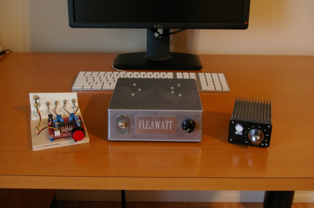

Below is my "red board" TPA3116, the FleaWatt, and Firestone Big Joe V1.3 for size comparison.
I love the FleaWatt case, it's solid as a rock and well made, not to mention Derek's workmanship inside is impeccable.

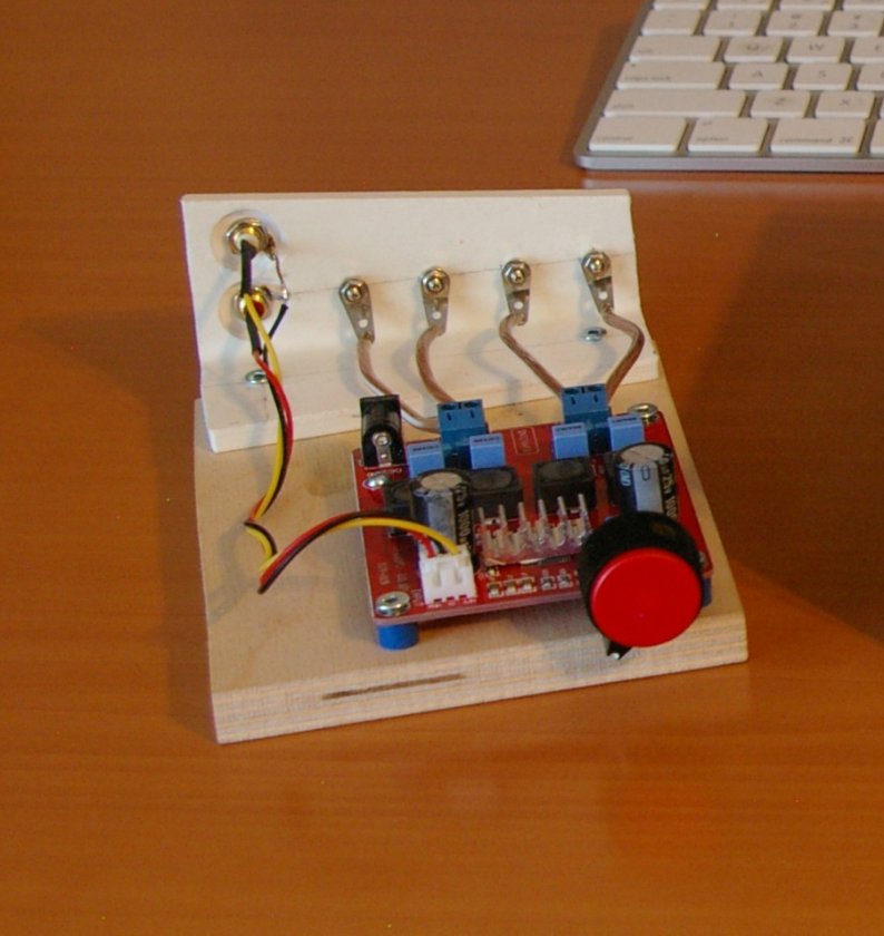

I just finished building my own "Fleawatt" putting my red board in the same type of case as Derek does, except mine is considerably smaller.
I think I now know why he uses the case he does - ease of moving around inside when connecting everything up.  It was a challenge in my little case.

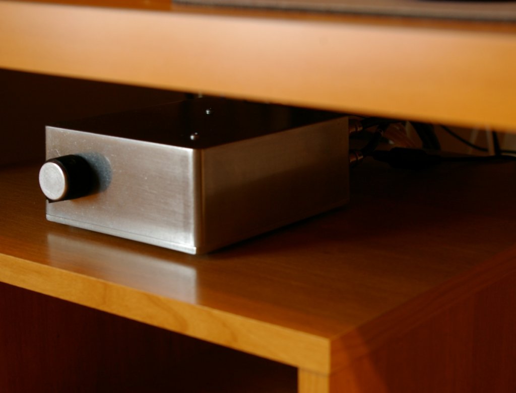

I finally bought a small Hammond cast aluminum chassis to put my red board TPA3116 in.  It's a bit smaller than the one Fleawatt uses, thus being a little more difficult to work in, but the red board being very small, makes a pretty good fit.
I downsized the multi ply wooden base and mounted it upside down in the chassis, that way I got away with using two tiny #4 panhead wood screws.  The wood should help with resonance damping too.
The volume control body is mounted to the chassis front and the PCB mounted with four plastic standoffs, making sure not to flex the PCB.
The signal wires were braided to prevent or lessen crosstalk between them.
The case was buffed before final assembly.

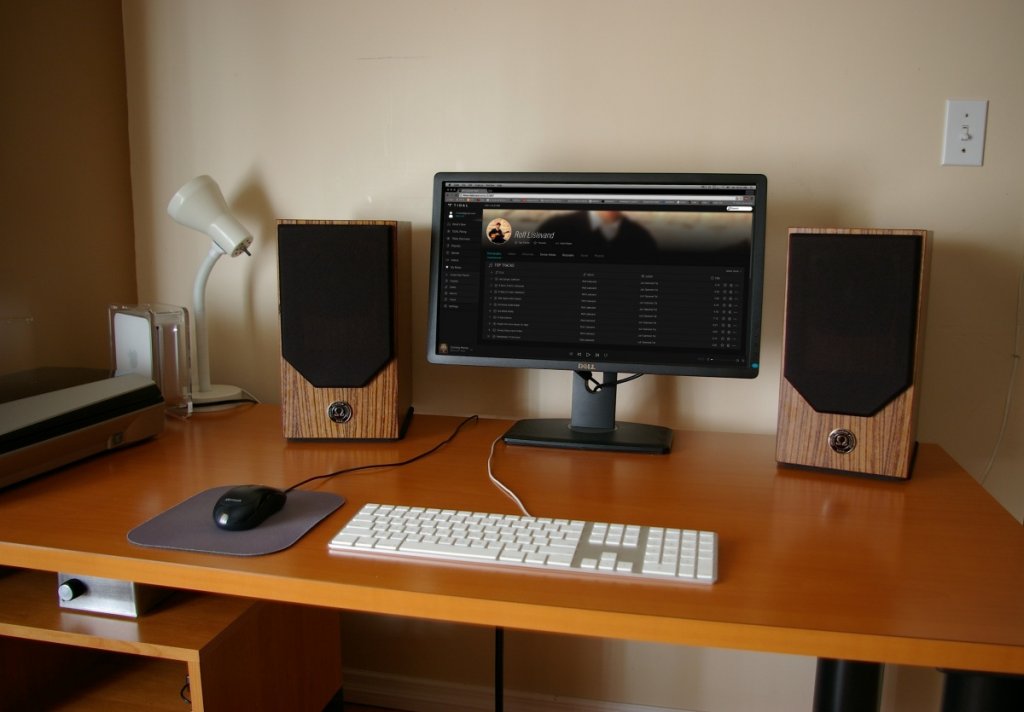

The system in the picture is the "lowest common denominator" setup I've put together.  Wanted to see how "low" a system I could put together and still sound good.
I'm using only the headphone output of my 2009 Mac Mini, a 3.5 stereo to 2 RCA adapter into a $40 three foot Monster interconnect straight into the amp.  Basic Monster 16g speaker wire is used.  The speakers are Super 3i.
Amp: $155 (less if you build your own)
Speakers: $595
Interconnect: $40
3.5/RCA Adapter: $10
Speaker wire: $4 (50 cents a foot)
Total: $804
The sound: Sweet, detailed, spacious, and open without a hint of harshness or sizzle retaining good dynamics at low volume, yet able to be turned up without getting congested.
